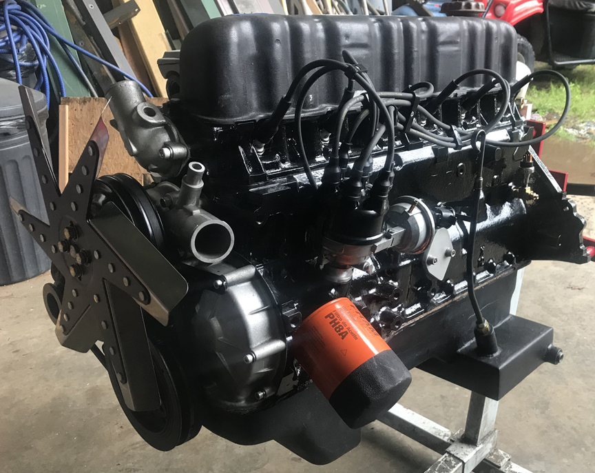

Getting a little more done on the motor, I got my distributor in and close to the correct time I think, I will have to pull it back out so I can do the pre-lube but should be able to slide it right back in.
I put the temp gauge port in and the oil pressure switch for the fuel pump, going all mechanical gauges so I should be able to just hook them up and temporarily mount them facing the engine bay for the cam break-in.

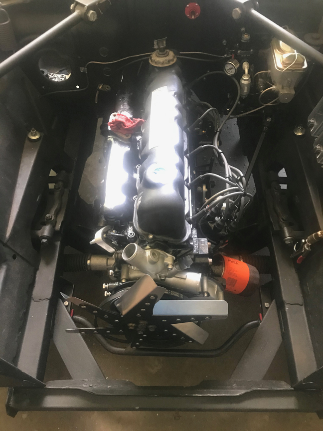

Motor, trans and driveshaft are installed, about time to tackle that intake project.
Hopefully I won't be pulling anything back out except the head, I need to do the modifications on the intake and install the valve springs.
See Ya,
Mike

chad":33g0mm2s said:
that block hada draft tube?
No, where the draft tube is on the earlier engines is where the engine lift tab is, I took it off after setting the motor back in and put the bolts back in the holes so I wouldn't loose them incase I ever need to pull the motor again, I just didn't like the look of the bracket sticking up there and the rear one will hit the new intake.
Looks like some frame extentions
made up? I C a lill lip there?
It is the metal plates wrapping around the original frame for the Mustang 2 install, I did make them from an old doublewide trailer tongue I had. :P
It is pretty cool having the complete running gear installed, I am ready to fill the transmission and hook the line up to the hydraulic clutch slave and get it filled, not sure yet if my push rod on the slave is pushing too hard against the pressure plate, it all fit in there snug and I am playing that one by ear because I never did that kind of thing before. I think the throw out bearing always rests on the clutch fingers, it kinda has too.

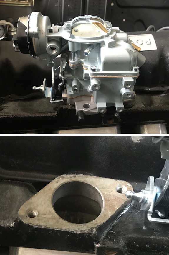

I ordered a clone Ford 1 barrel carb (Carter YFA?) off eBay today, going to put it on the Comet so I can try and get the car started.
I am more than little nervous about trying to start the car for the first time with the triple deuce setup and actually get it to run, I decided it was better to attempt a start it in basically a stock form, especially with all the other things I am doing on the motor, I know it won't run to peak performance by any means just needs to make 2500 RPMs for 20 minutes to get the cam broke in. It will be a good opportunity to start working out bugs as well while I work on the new intake. The only other expense I can think of doing this is having to replace the head gasket.

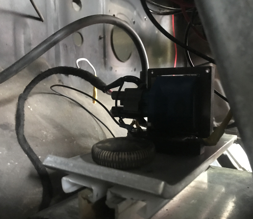

Started getting the wiring harness built today, there certainly if a lot to do with that alone, just making a harness to run the car for now and will add all the extras later, the hard thing is not having everything I need and having to order stuff, that slows me down. I did get the ignition system wires almost finished up today so tomorrow or so I will build the coil/ICM mount that is going under the dash (behind the console)

I got my break-in carb yesterday, I was wondering if anyone had a carb base they would be willing to sell, loan or rent to me? I have not found my original one yet and I am not sure how good it is but need one to be able to bolt the carb on.
I finally got my ignition system installed, I mounted it all on a slide out tray so I could easily change out the flux capacitor if/when it goes bad (you might call the flux capacitor a ICM or Ignition Control Module, but I know what it really is :roll: :P )
I still need to put some thermal grease under the flux capacitor and get my wires routed better.

I like that color for the motor and it looks awesome in the car. Kind of dangerous looking. As if Darth Vader built it to power the Death Star.
chad":2fll1gox said:
https://www.vintageinlines.com/product- ... acer-6-cyl
only 1 I C, $55+S/H might B "Re: My Budget 250 build" ?
I think that one has too small a bore but not positive, a little more than I would like to pay as well for something temporary but I may have too :roll:
:P :P first time I have ever been compared to Darth Vader and I think the dark side is the V8 crowd :roll: maybe? I like the black and silver theme.
