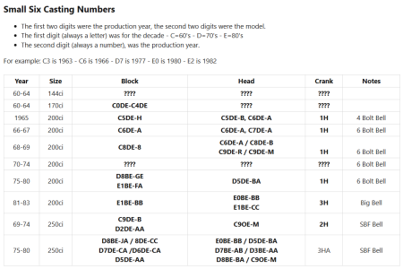

I currently have a 1966 mustang with a stock 1966 200 engine and c4 transmission. The engine needs a rebuild and I don’t know if the transmission works or not. A guy in my area is giving away a 1981 200 out of a fox body with the matching 4 speed SROD, and I am trying to figure out if the 1981 engine would bolt into my 1966 mustang and mate with the c4 transmission without major modifications. Does anyone know what issues I might run into trying to achieve this?
Probably a good plan to get the block casting ID numbers to make sure of what you have and what you are getting from the fox body. Someone knowledgeable will show up with the answer based on verification of casting numbers. Pics of each unit are always helpful. However if you can get that 200/SROD for free I would get it as these items are getting hard to find.
