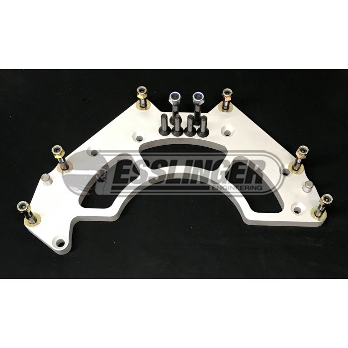

Parts:
This is cheap. Adapters that will enable this engine to mount too a SBF housing.
