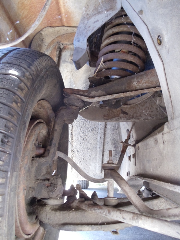

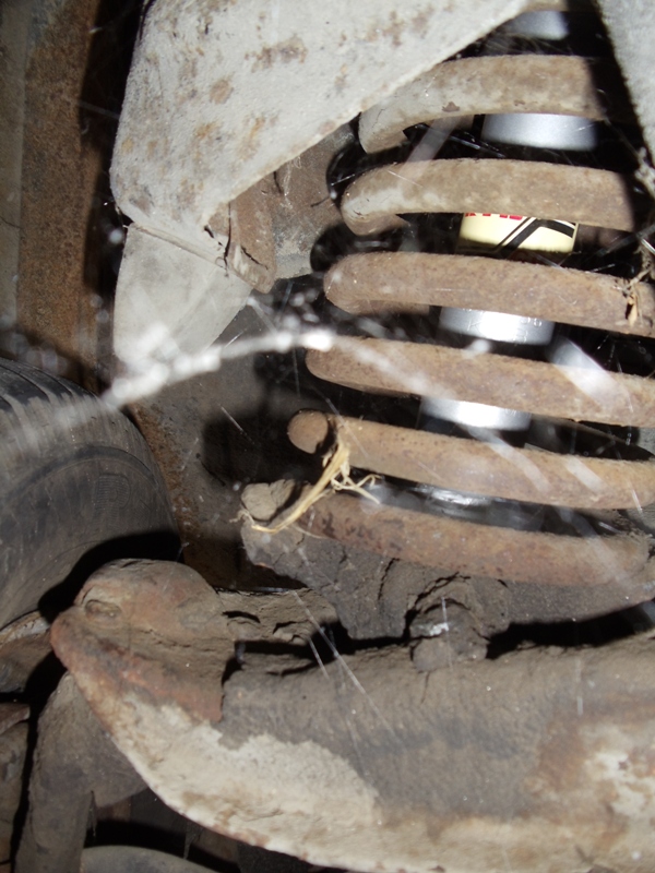

I'll get a picture of the front suspension tonight or tomorrow. IIRC, it's rubber in there. Anything else I should look for?

Here are two pics of the front suspension, hopefully what you need!
Larger versions of the same pictures:

Thank you!
The last cars I worked on were a 65 Falcon Futura (6) and 66 Mustang (V8). Yours looks like the same parts except for the upper 3 bolt ball joints some times these were just converted to later 4 bolt ball joints.
These are the Org. type Front end parts
So as long as I am changing the upper a-arm, I can use whatever ball joint it requires and it'll match up with the spindle ok?
If so, I'm just gonna pick up one of the kits out there & call it a day!
Thanks!
Sure are they damaged? The 3 bolt & 4 bolt ball joints are the same price and both are still available new. If you want you to change the A Arms to a 4 bolt ball joint Part # C4DZ-3082-B fits 1963-1965 Falcon & Comet 1964 to 66 Mustangs On new Lower A Arm Part # C4DZ-3078-A fits 1962-1965 Falcon & Comet 1964-1966 Mustang. Good luck with the hunt
