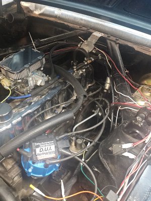

The line that ties into the blue metal line is how the vacuum is routed. Under the metal support is a tee that connects to the transmission.
I dont have a line that goes into the air cleaner and I don't see anywhere to hook one up to.

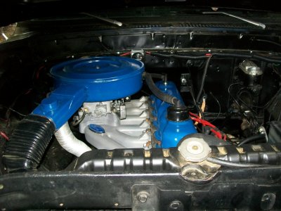

Dang it, I'm confusing threads again- my bad. Thanks for the pic. That Tee where the PCV comes in is in the worst possible place, oil can run directly into the booster. The Tee should be at /in the intake, with the PCV going straight into the intake, and the other vacuum sources coming in from above. A Tee that threads directly into the intake provides the best flow.
It's obvious you have an attractive planned-out engine bay. Looks nice. Rerouting the lines may not look as nice. I have spent hours on end routing electric lines and hoses for a clean look, so I get it.

The intake nipple can be rotated the other way to run everything toward the rear below the carb. A Tee would fit in place of the manifold fitting there now also.

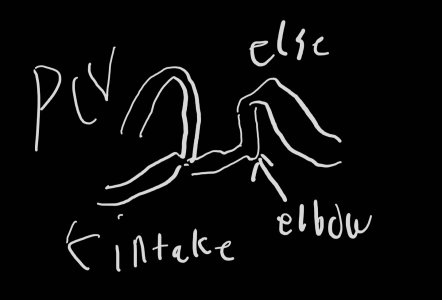

So from what I gather the pcv valve needs to be lower than the rest of the vacuum. So couldn't i add an elbow pointed upwards to get the same effect that the tee would?
This is mostly a what if. If it would work I can keep it as a backup plan or quick fix. 1000007230.jpg
That's better. No matter what, every time the vacuum spikes from low to high- like every gear shift, or decelerating- oily vapor is shot toward every far-end of the system.
It's a fluid dynamic characteristic- when vacuum increases in an airmass with heavy particulates, the particulates are drawn in the opposite direction of the vacuum source, and toward the walls of the constraining tube.
A good visual of this principle is the windshield repair kits. Some glue is put on a crack, and a suction cup applies vacuum. Logic would say the vacuum would draw the glue toward the vacuum cup. In reality, the vacuum causes the glue to move to the farthest, deepest recesses of the crack.
It will take a while for blow by residue to affect the modulator valve and brake booster, but don't doubt it's getting in there, because it is. The closer to the intake the blow by can enter it, the less of that oil air is available in the hose to activate the booster/modulator.
Probably overkill, I always isolate PCV from everything else. Even when, in one case, I had to buy a carb spacer and drill/fab a port in it for PCV and use the intake port for the rest.

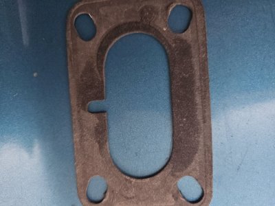

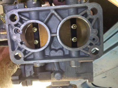

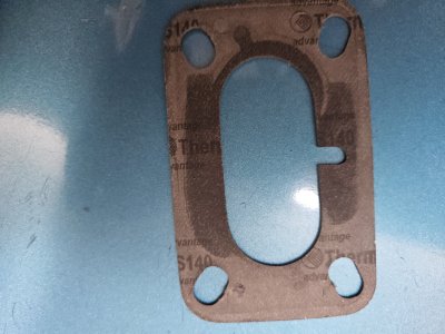

Alright party people. I've tried the weber a second time and im running into issues with the adapter. I cant get the carb to adapter gasket to seal. So i either need a different adapter or im going to try a plastic spacer that redline sells. Maybe that will distribute the pressure better.

But when I completely closed off the choke to reduce the air that comes in the engine sounds very healthy. So i think this carb will be promising if I can stop this vacuum leak
Also with that adapter the studs on the manifold are slightly too tall to where you have to hold the adapter up to thread on the nuts otherwise there isnt enough room and the nuts gouge the adapter trying to tighten them
that's a good thick gasket. Be sure not to overtorque the carb studs! The carb base will warp out of flatness.
