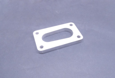

A simple fix would be an 1/4” aluminum plate fabricated exactly to the original Weber 32/36 spacer plate. Then use two properly sized gaskets to sandwich the plate between both gaskets.
These would be some good spacers if there is enough hood clearance.
32/36mm Weber DGV DGAV DGEV flange or spacer

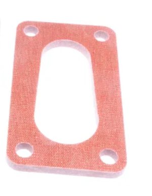

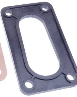

@63 Sprint Correction im getting a 1/4 inch phenolic spacer and a 1/2 inch plastic spacer. The plastic comes on Monday. The phenolic spacer hasn't been shipped yet. They came as a package so I have no clue why they are being sent separately 🤔
The plastic should seal pretty well it looks like the phenolic but its just a different material
Ok, please take pictures of the phenolic spacer.
I think you mentioned that the elongated hole on the phenolic spacer is tapered as the aluminum spacer pictured in EBay on post #224. It this correct?
Its more tapered than the plastic one but the plastic is still tapered. If you're viewing on your phone if you turn the picture sideways its easier to see the taper

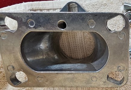

When looking at the adapter again. It looks like there’s too many imperfections on the adapter flange face that the plastic spacer will not seal properly.
Use the phenolic spacer.

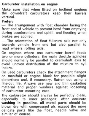

No. According to weber the fuel bowl is supposed to be facing your radiator so it need an adapter that puts the weber perpendicular to the engine

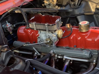

That’s not correct geometry for the carb. Tne carb wants to have the choke facing forwards, linkage on the exhaust side, bowl on the valve cover side. See the attached photo.
Hopefully the phenolic plate with a gasket on each side will provide a better seal. It definitely sounds like the vacuum leak is at the studs.

beanmiester is correct. The fuel bowl faces towards the front of the engine. It’s written in both my Weber service manuals that I have.
I personally questioned Redline/Weber about this about three years ago when the question came up on this forum. They also firmly agreed that the fuel bowl faces towards the front of the engine. There are good reasons why.

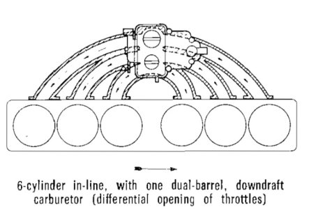

Here is a few paragraphs directly from the Weber shop manual:IMG_0468.jpeg
The picture below is just one picture of many in the service manual. Every engine (whether it’s an inline 4, pancake 4 or 6, inline 6, V6, V8) shows the carburetor with the float bowl facing towards the front of the engine. No matter which intake manifold is being used.
It’s unfortunate that much misinformation has been posted about installing Weber 32/36 and 38/38 carburetors. It’s very unfortunate that many members tend to believe that the misinformation is true. I’m sorry, I’ve done my homework and research on this matter and I know what is preferred and what is not. Weber wrote the preferred installation procedures for a reason. So I guess, it comes down to what members want to believe.

There is no doubt that orienting the bowl to the front is correct to avoid fuel delivery issues under acceleration and braking. That is the way all of the carbs I’ve seen are designed and when I installed a 32/36 on my hot rod BMW back in the day that was the only way it would fit on the intake. The reason these carbs are installed on a log intake sideways is because it is not possible to install the Clifford/Redline kit any other way with the adapter provided in the kit.
The reason why you can’t orient the carb with the bowl forward using the kit is because the adapter has 2 mounting holes to mount to the log. If you use the OEM water cooled base below the carb, the carburetor will be positioned at an angle to tne front (roughly 60 degrees to the front) and it makes connecting to the throttle linkage pretty much impossible without switching to a cable. If you don’t use the OEM water cooled base, then it fits only one way, as shown in the photo I posted.
When I installed my 38/38 kit last year, I had questions so I spoke with Larry Millwee from Clifford Performance specifically about this configuration. Larry wrote the instructions that came with the kit. I sent him a photo of my carb mounted as shown in the photo I posted above. He concurred that it was oriented correctly and advised me on how best to connect it to the existing throttle mechanism. At no point did he suggest that it was advisable or possible to orient the carb with the bowl forward.
Anyway, that is my understanding of whey 99% of Weber 32/36 and 38/38 carbs on log intakes are mounted with the bowl facing the valve cover instead of forwards. Fortunately, in my experience running this carb for the last year, there is no problem with fueling under acceleration, breaking or left/right cornering. It seems pretty flawless.

Mine is mounted with the bowel towards the valve cover (200 engine). I have never had any issues- and changing the orientation would take some major mods/fab procedures. I do not have access to mills/ lathes ( sadly ).
I do understand why it is PREFERRED to mount it with the bowel forward. And maybe in racing applications- necessary, for reasons of momentary fuel enrichment and fluid dynamics and atomization in the air flow but for daily drivers and people with limited tool access, bowel sideways is our only realistic option.
