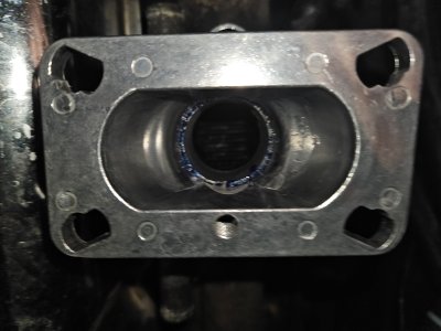

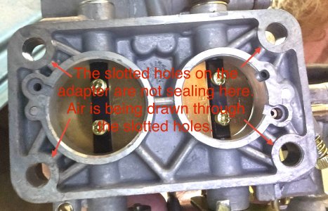

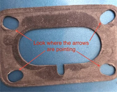

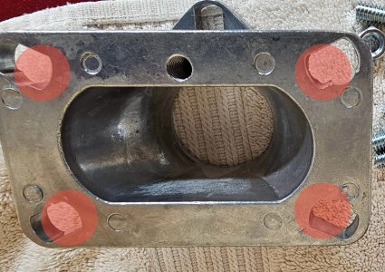

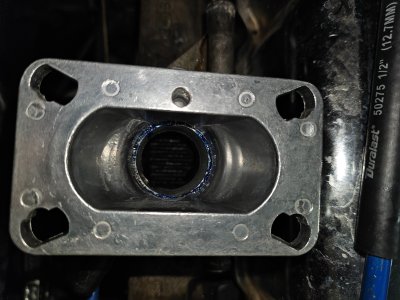

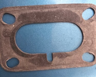

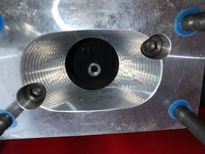

Doesn't change much, but there aren't any studs for the carb. I had to buy bolts and make a washer sandwich to hold the carburetor on. The adapter isnt threaded at all besides that one hole in the middle i don't think I can tighten that enough to warp it. My left arm isn't strong enough to hold it back the bolt if I were to really try and muscle the nut down 😂

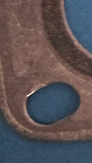

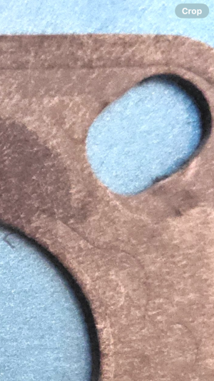

They were snug then I gave it a little bit of a turn after that for the lock washer to fully engage. That should have been more than enough to get a better pattern on that gasket but it barely sealed

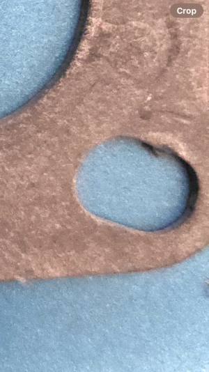

Oh, wow... That adapter isn't like the one I have. I'm not sure I'd trust that to seal without studs.
This is what mine looks like. It came in the Redline kit. It requires almost zero torque to seal up nicely. Yes, that's a nut in my intake. Whoops :ROFLMAO:
That adapter looks the same as one I have in a box somewhere, $15 from Amazon or ebay. Generic wide-slot fit for small base Rochester on big six log intake. Not saying it's the same casting, but may be- just has the "look" of coming from the same overseas place.

I looked everywhere for that adapter and can’t find it at Clifford, Redline or Vintage Inlines. I did find an EBay vendor who has a kit for the 200 with that adapter though and it looks like it needs some kind of threaded inserts and it uses studs: https://www.ebay.com/itm/273885224140
I wonder how square the face of it is. If I was having trouble with the seal, I’d mark the face of that adapter with a sharpie and then get a piece of stone countertop (a shop down the road gives away remnants) and put some 2000 grit on it to see how true it is (by gently wearing the sharpie away with the 2000 grit on the countertop remnant). It would be useful to have the studs and inserts as well.

"I looked everywhere for that adapter and can’t find it at Clifford, Redline or Vintage Inlines. I did find an EBay vendor who has a kit for the 200 with that adapter though and it looks like it needs some kind of threaded inserts and it uses studs: https://www.ebay.com/itm/273885224140"
Thats the one i have but there is nowhere to thread said studs. its all smooth on top of that adapter
Also the adapter and carb are flush so its not an issue of either being warped its an issue of the fact that it cant get enough force to clamp them together

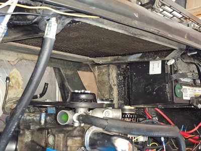

Also also the aluminum radiator is coming along nice

Man, it still seems clear there is a significant vacuum/ air leak somewhere in your system. A carb gasket will not bleed enough air to cause this extreme leanness.
Remove and plug all vacuum lines. Spray brake clean around the ports/ intake-to-head gasket.
The original symptom which led to a carb swap has not been resolved.
