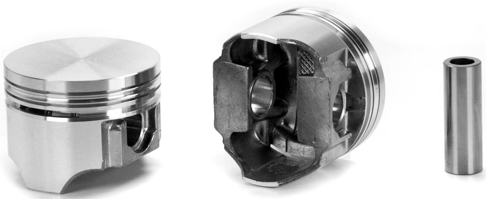

Got some info on the block. It’s been bored .060 already but looks good with no run-out. I’m assuming the popular belief with go with it? I haven’t ordered pistons yet but found .060 over flat tops. I’m dropping the block off Friday to the machine shop. They’re wanting to know how much I need taken off for 0 decking. I’m assuming I can just put the pistons back in and and measure from the highest one to top of the the block for that measurement? Does anyone know if the flat top pistons are same height as dished?
Silv-o-lite hypereutic 3327h.060 is what I found. I believe that’s what I need. Found on summit racing.
What I found on net is 1.530'' and stock is 1.511''. So if true that is .019'' taller but most replacement piston are made .010'' shorter.
Stock deck height run about .021''-.026'' so not much of a cut will be needed.
Get one piston if you can and measure, and compare what have now for deck height with assembled parts you have, no guessing.
Also your machinist can see if the pistons will work with your bore.
