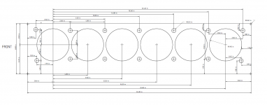

PDF attached in addition to this screenshot. I think I got all your measures - the numbers were within .001ish.
Had a couple of nice email exchanges with CCA/Protohawk and the owner Mike offered to sanity check us.
  • fordsix-200-smallsix-honing-plate.pdf

So what did Mike at CCA have to say, did he have a drawing of the 200 ?
It looks like BHJ should have one.
Sorry for the late reply - I just sent the PDF off to CCA. It's been one of those days this week so far. I could tell you about it but this is a family friendly forum and my happy place.
