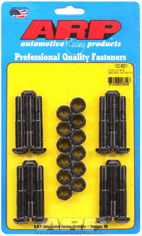

ARP rod bolts, can I order now or do I wait for some measurement later?
If now any leads, or special type?
Thanks

You listed the rod length at 6.21 They will actually be shorter after they are resized with ARP bolts.
Measure them now and see what they are.
