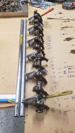

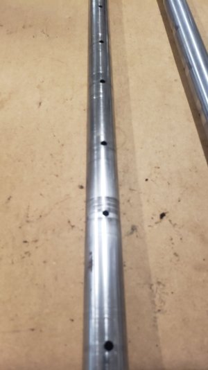

Hi All, I have bought two of these already, but keep getting sent assemblies that have the oil inlet at the end of the shaft. My 62 F100 has the oil inlet located in the middle of the shaft. The one I have is all chewed up, so trying to find a replacement shaft with the inlet hole in the middle
My original is on the left. Punches marking holes to show what I am talking about
I'm not sure what it costs. But Rocker Arms Unlimited (and probably some other places) can fix your old shaft.
I Spoke to a machine shop today and they can drill an inlet hole for me, but I'll need a new end plug so I can clean out the metal shavings.
Does anyone know where I can get a 35/64 end cap?
