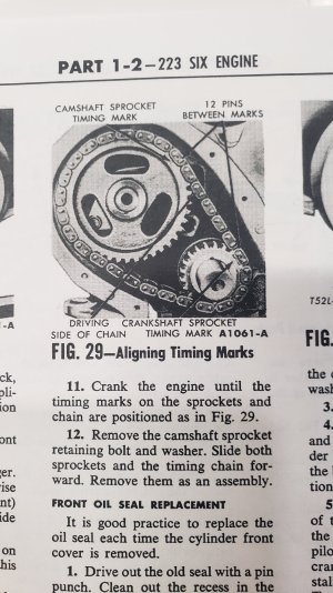

Make sure the timing chain and gears are oriented correctly. It’s not the standard line up the dots technique. You have to line up the blue link or something like that. I’ll check the manual tomorrow when I get home from work.
IIRC the parts are the same as the ones used in the V8 Y Block.
Quick update. I got it running. The distributor was 1 tooth off.

That’s great news! I knew the timing had a non conventional setup but couldn’t remember exactly, it’s been 11 years since I set mine up (after a no-start).
