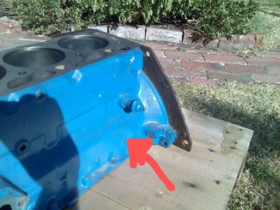

Does the block have an engine number stamped on a flat pad .
Left side ( looking forward)between fuel pump and oil pressure sender
Australian ford falcon blocks had the following serial numbers for 200ci
All ford Australia 200ci narrow block engines and from usa/ canada manufacture as ford Australia didn't manufacture a 200ci in Australia for xm and xp falcons - imported them.

As your block starts with a casting number of C5 it was 1965 American ( or Canada) supply.
All Australia manufactured engines start with ARC.
Other possibility is a Mustang engine - which won't have any above serial numbers stamped in.
Flat pad is about here:

Like i said , Get the engine serial number ,its stamped in.
The ARC number is the block part number and is part of the casting- not stamped
