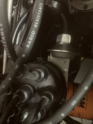

VA unit holds perfectly at least 18”. It will be a few days before I can test for exhaust restriction.Check off list:

• Distributor: run vacuum canister leak down test.

I hooked a vacuum pump to the distributor, pumped it up to 18”, and watched it stay there for a couple minutes. Do I need to watch it longer?18” of vacuum doesn’t tell us if the leak down test passed. If you have a vacuum pump, hook it to the distributor vacuum canister and see if it holds vacuum.
Brand new. I also have a good backupHow old is the ignition coil?
Yes. I only went up to 18”, and it held perfectlyI believe that in the previous post the canister hold 18in of vacuum![]()
