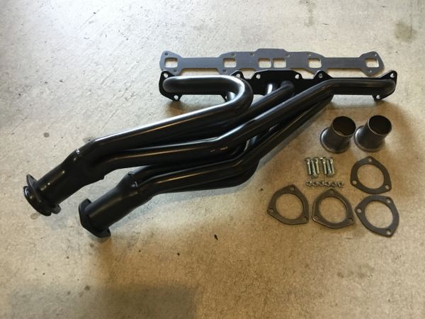

what the OP is lookin at:
It just gathrs 123 ina line and 456 for the 2 collectors.
That's what they look like, except there stainless steel, not painted. I had to re tune the carburator because the air can flow way better. I went with 2 1/4 straight back. What can ruin the sound is if you put an X or H pipe. For some reason either one works great on most V8 motors. I'll try and get those pics up in the next day or 2.

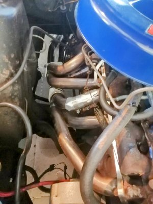

Some pics would be great. I'm most interested in how they fit to the engine, how they clear everything (intake, alternator, shock tower, etc.)

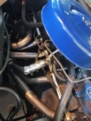

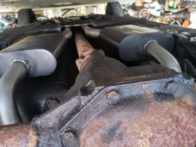

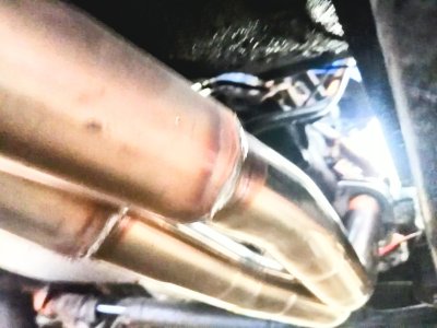

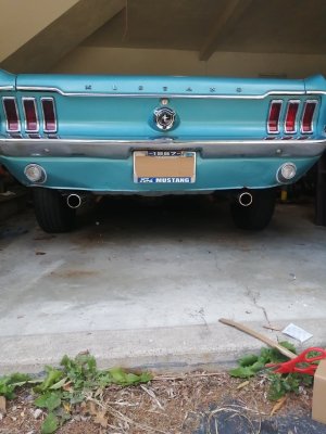

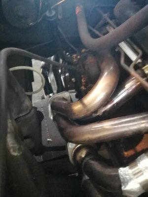

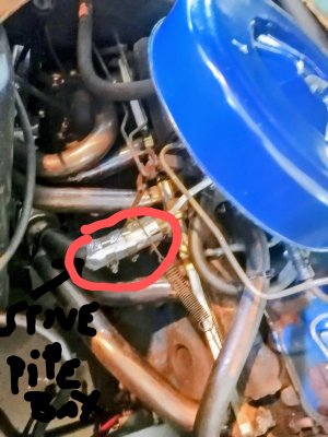

Here are some pics. I did the best I could. NOTICE temporarily made a make shift stainless steel stove pipe hut /box attached with hose clamps for the choke to open and shut. Actually works great, better than old pipe filled with rust and dirt.

Maybe due to long tube headers? What brand headers?
Sorry for the late response. Ebay stainless steel long tube headers. 2 1/4" all the way back to flowmaster 40's. No Y or X pipe. Question : since it's probably gonna be never to be able to get my hands on freaking awsome aluminum intake that unfortunately stopped making after the designer who will be missed by everyone very unfortunately passed away. What would you consider a next best option, " other than trying to get a 250 Aussy head" . I was leaning towards the 1v to 2v weber kit sold with all the jets tuned to for 200 inline 6. Looks fairly easy to install. Between what I picked up on the long tube headers the motor now being able to exhale, would the Weber setup give it enough to inhale enough gas and air to make a noticeable difference, or do you have another suggestion for around the same $ and easy enough to do in my garage.

Good to hear that they fit perfectly for @jcom4179. That's encouraging. What year and model is your car?
67 mustang convertible. I did the magnet test with a pretty powerful magnet maybe neodimion. Did not stick to any of the header pipes. Which is a good thing👍. I truly thought it was gonna pull right out of my fingers. It stuck to everything around it. Wish I put on rubber gloves. Everything under the hood of a vintage car somehow has grease on it.
