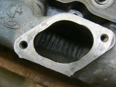

Here is an enlarged intake bore on a 65 small log head which is very close to the size of a stock large log intake bore. The bottom of the bore has been radiused.

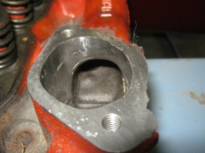

Here is an enlarged D7 large log intake bore. The head is from a 78 Fairmont. The 78 Fairmont also has a D8 head
