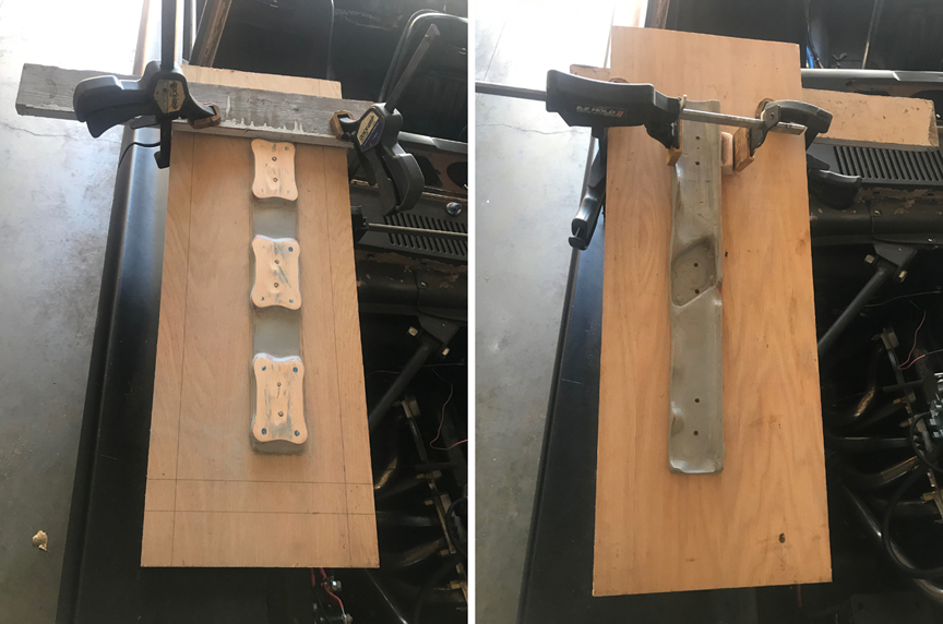

Finally getting started on the custom cast intake again, just got the two pattern halves mounted on a board so far, but this part should move along fairly quickly, not so sure on the flask construction that may take a little longer just because I will have to get some supplies.
When I get this cleaned up and the gates and sprues added I will paint it all with some glossy paint to seal it up. My major task on this project is coming up with 75# - 100# of green sand, I have no idea where to get that around here (I did see a video about making it out of pool sand and kitty litter I may try).

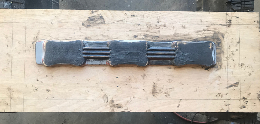

Working on the intake again today and decided it needed some ribs because it is a rule that aluminum speed parts always have ribs :roll: :P
I brought it in the house for the night so the epoxy won't take forever to cure, then I can get it cleaned up and smoothed out.
Ok, so it took a while to execute those but I guess it will be worth it :P

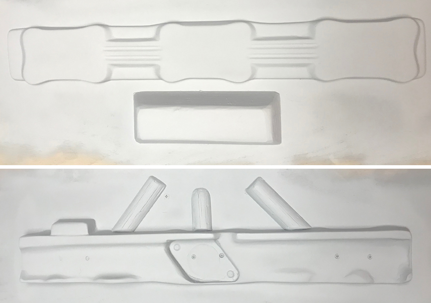

Continuing on the intake pattern, I added a basin(?) and some sprues/gates to it today. I went ahead with putting the top on the bottom of the pour, so it will pour upside down.
I need to do a little filling where the sprues meet the pattern and I will be ready for paint, then to get the flasks built.
