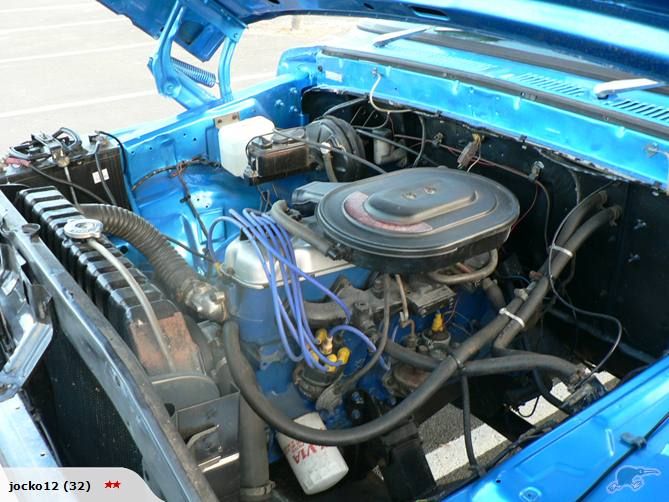

The stock 1976-1979 Falcon or Aussie market F100 will have the right hose off the shelf. It takes but a few days for one to come from Aussie or NZ, they are common as french fries.
Or order a 'special' off the shelfer hot rod hose from Gates or Dayco like this item for the Aussie F100
