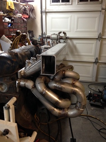

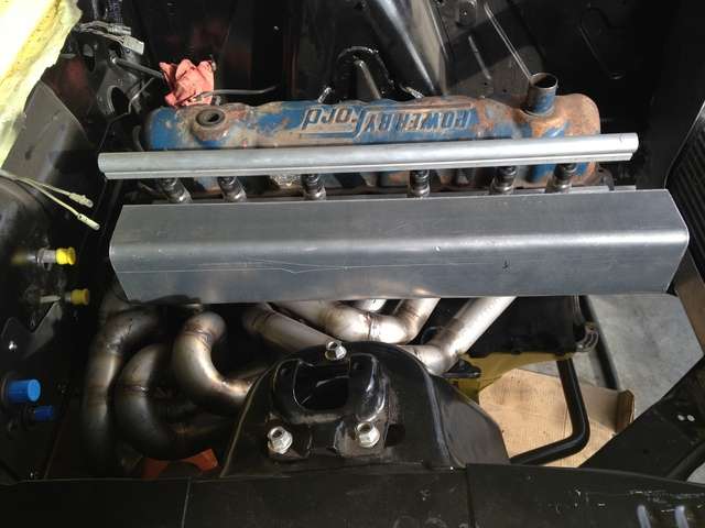

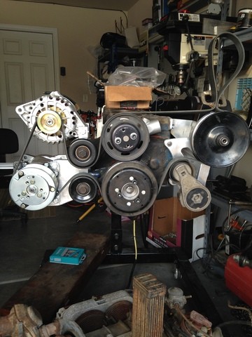

I have my intake and headers mocked up on the engine.  I'm going a little different direction than most people on the forum, so I'm posting some pictures
of the build so far.
https://imageshack.com/i/pa6TIawvj
https://imageshack.com/i/p311VtSBj
https://imageshack.com/i/p3Ogt7PCj
The head has been ported - I'm using 1.46 ex. and 1.75 int. - have forged pistons and a.r.p. bolts
I'm using Holley HP for my fuel and ignition management and Ford throttlebody

  Getting very close to having all my engine fabrication done - next step is to wire in the computer and start it up!  I decided to abandon the 40 EDIS and go with coil on plug because I can fine tune the dwell more precisely.  Hopefully the next time I post the engine will be complete and painted - getting excited
