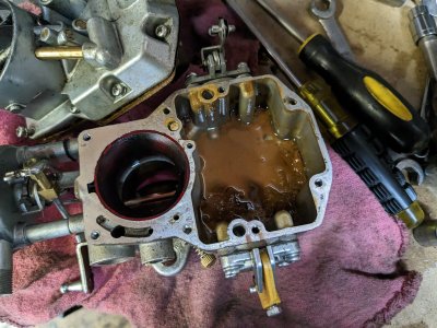

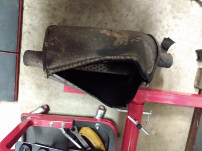

My reasons for putting the Weber 38 in place of the stock Autolite 1100 copy that was mounted on the car were due primarily to the increased capacity for air given the 250 head, headers, and a 2.25" exhaust that I put on the car. The previous owner was trying to make the stock carb work on the large-log manifold without an adapter by hoping to fill the extra space at the bore with gasket and goop. This made for a huge vacuum leak and very poor performance-it barely ran at all. In fact, so much extra fuel was escaping into the exhaust that he grenaded the muffler on the car. The fuel system was completely trashed. The second pic is of the inside of the original carb.

Thank you Kristas very much for the information. Wow those pics are pretty scary. I have to contact the website I'm buying the 38 kit from to get the measurements of the adapter plate. I just want to make sure I'm buying the best 2v for my mustang. I'm pretty sure a guy Don I chat with on the forum put a 34/36 2v weber carburetor on his 67 mustang and liked the results, that another option. I read online that a 38 weber would give the best performance for a 200 inline 6 with long tube headers and true dual exaust. Either way I go I will post my results.

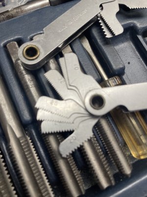

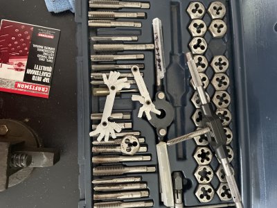

It should be 5/16-18. I didn’t think about it till I got back home, but my head as been modified to be a 2 barrel, I would sure think he would have used the same size threads.
2 things you could do:
Go to a hardware store and buy a 5/16-18 bolt and make sure it fits.
Or more productive in the long run, buy a tap and die set, they should come with little guages that determine the thread pitch, then you can use the tap on a nut or die on a bolt ( with the correct pitch) and determine the bolt size. In the long run, you can use it to repair/ clean threads, especially before torquing
