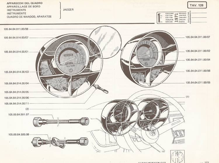

Your point of difference is using a less obtrusive smaller diameter speedo and rev counter, so your missing the base nacelle which is a "fairing" into the metal dash structure.
Somewhere, you have to look at re-establishing the diameter.
If I were you, I'd put a whole bunch of OBDII check lamps in and around each dial, and use it to trouble shoot from your MS system.
Make them covered by black mylar, and only energised when a fault or check sequence is in process.
Basically similar the the AlfaRomeo Montreal.
