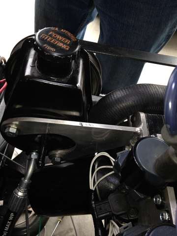

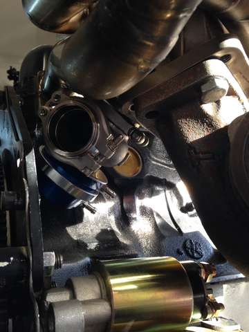

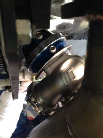

Started working on the car again over the holidays. Had a hell of a time figuring out where to put the wastegate on the header. The places I planned on installing it did not pan out - not enough room. I kept postponing the decision (always a bad idea) mostly because I couldn't access the header to weld in the wastegate flange without pulling the engine :bang: I finally figured out where it would fit and my worst fears were realized - out came the engine. So I took a few steps backwards but It ended up fitting perfectly in the original starter location. Since I have the engine out, I'm taking care of a few other details and will (hopefully) install it for the last time! I am now motivated again to get this car running!
Picture taken from bottom of engine looking up
From top looking down

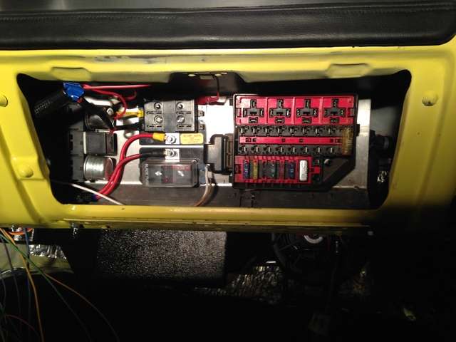

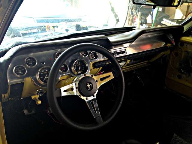

Latest update - finally have most of the wiring finished - I would recommend spending a the extra money and getting a quality wiring kit - it will save you a lot of time and frustration. Fabricated a transmission bracket because my the engine and trany sits 1 1/2 inches back from stock - that was surprisingly more difficult than I thought it would be. But, everything is now installed permanently. Still have a few things to do like the throttle and clean up some of the wiring. Finally started it and it fired right up even after a year of sitting! :D So happy to be moving on to brakes and suspension - should be on the road very soon! I have a question on exhaust: I'm running a 3 inch pipe from the turbo and then split to dual exhaust. I'm thinking of running two resonators with no muffler but am concerned about too much drone on the highway - should I use a muffler also?
Start #2 (Youtube Link)
Pic of fuse panel:
