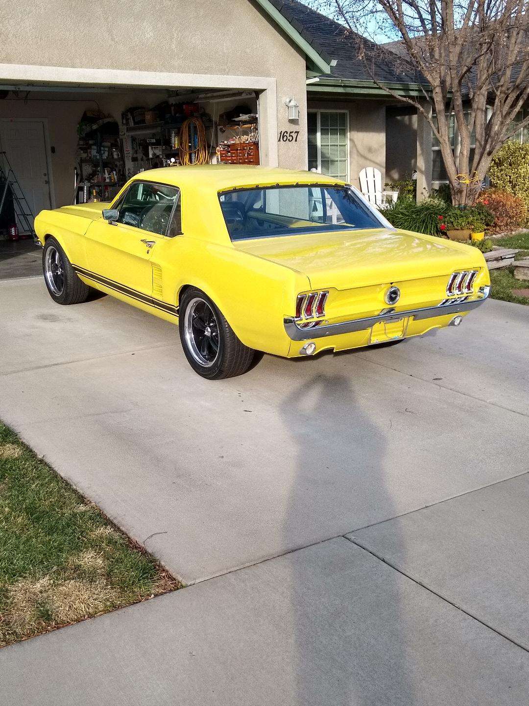

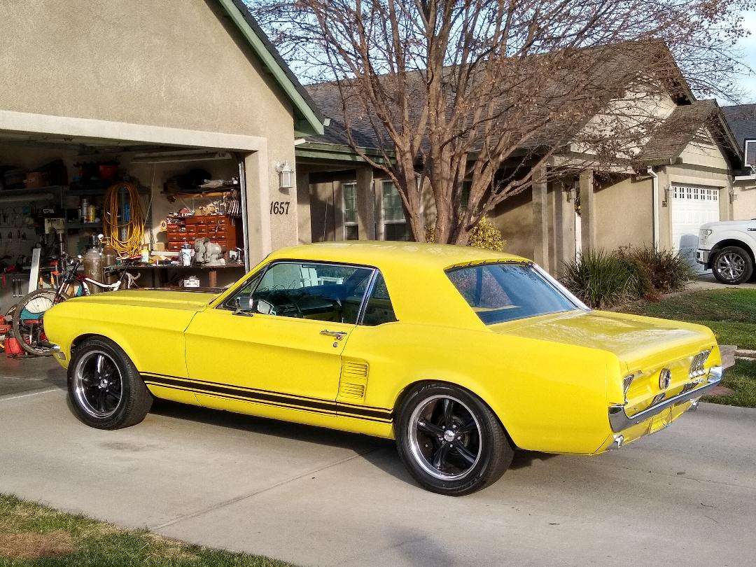

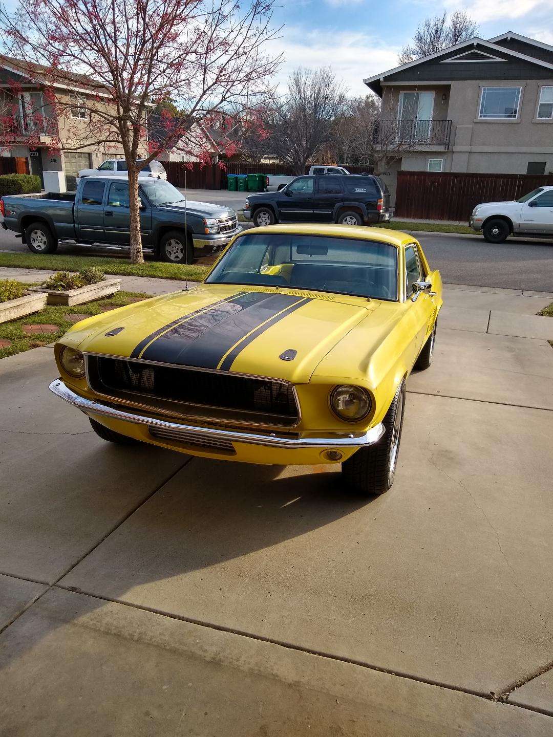

End of year update: we put a new tune on the car and it purrs, starts right up, and the fuel map is nice and smooth now. Been working on finishing the rest of the car - have to polish and wax and put a few finishing touches on the interior. I'm still searching for original window trim to finish out the windows (If at all possible keep your original window trim for the windshield and back window - the new stuff is absolute crap)
Because of the cam, the aluminum flywheel and highway gearing I have to get the rpms up to get the car rolling - once the car is moving it is FUN - the acceleration is awesome and I still only have 4psi of boost (after I put more miles on the car, I'll start increasing the boost). I'm going to install a true trac with 373 gears which will help get the car off the line nicely. I think the lower gears will suit the engine better.

Thank you. My wife gets the credit for the paint job turning as good as it did. She put in a couple hundred hours block and wet sanding (more than I was willing to do) She also laid out the tape for the stripes because "apparently" mine weren't straight :?
